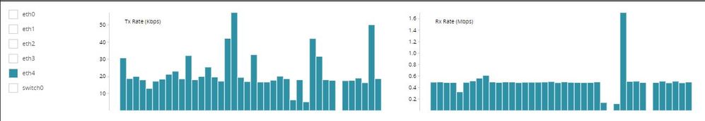

These pictures say it all to me. The Blue picture is the bandwidth on the port that the arlo is connected directly to. No other devices on this port. The green chart shows the bandwidth on the port that my phone is connected to. There are no other active Wifi Connections. I am running a live video stream from on camera on my phone. The arlo base station is streaming 400kbps up to arlo (rx blue chart) and then are using some type of on the fly encoding on their side and only returning (green chart receive (tx)) about 20kbps. Being that this is done with only a couple seconds delay, they are literally just discarding 95% of the data from our cameras. ARLO how cheap are you!!!??? This is a giant scam. I would love to see what the full 400kbps stream from my camera looks like, but ARLO wont let me.What this means is that I could watch the live stream from ARLO of 3-4 cameras over a 56k modem in low-tech terms. We are being scammed hard. Next step is to intercept the raw camera data in route to arlo and try to show, what my camera is streaming vs what arlo is returning to me. Go ahead ARLO and tell me i have wifi congestion issues when i show you the captured stream from my camera and what you kept and returned to me side by side.

The blue chart is showing the port on the router that the arlo base is connected to. Nothing else on this port. The green chart is showing the port on the router that my wifi access point is connected to. Nothing alse on this port and my phone is the only active WiFi device. The blue RX rate is the amount of data the router is receiving from the arlo base station. The green TX chart is the amount of data my phone is receiving back from ARLO cloud. I have live veiw running on my phone for 1 ARLO camera. My router is sending 400kbps to the ARLO cloud and they are returning 20kbps to my phone. Because of short delay I know they are using a very lossy encoding and they are essential discarding 95% if the data from our cameras. No not a typo. 95% of the data that my camera is uploaded to ARLO is being trashed. The amnout of data they are returning back is so small that you could live stream 2 arlo cameras on a 56K modem. How cheap are you ARLO?!!? I would love to see what the actual 400kbps steam from my cameras looks like, but using the app it is impossible to view. Also local copies show very poor quality which tells me this base station is just an access point and the local recording is actually just a local backup of the cloud data.
My next step is to intercept the video data directly from the camera and put up a side by side comparison of what I am sending ARLO cloud vs what they are storing and steaming back to me. Not sure if I will run into encryption issues, but I will try anyways, Basically, I'm pretty certain that my cameras are sending nice clear images over to NETGEAR/ARLO and they are throwing all the data away and storing and sending back trash.
