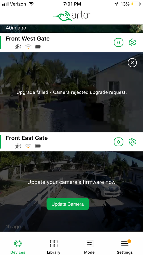

Installed/mounted today and all worked fine until I was prompted in the device area to upgrade firmware - Well 2 of my 4 new cameras upgraded with the new firmware fine - 2 cameras refuse - keep getting a message that upgrade failed - camera rejected upgrade. Now these 2 do not work - after paying to have them installed!
I’ve turned it off and back on - I’ve read bad news from other users - are these are buggy and irreparable? Or is there someway to fix the cameras so they’ll work again -

The installer should have handled the firmware upgrade. Right now, the fastest thing to do is to remove the cameras from Settings, My Devices and resync them (you may not need to pull the cameras down - I've successfully synced the cameras while still mounted at a distance from the base). What is the signal strength for these cameras? Have you restarted the base?

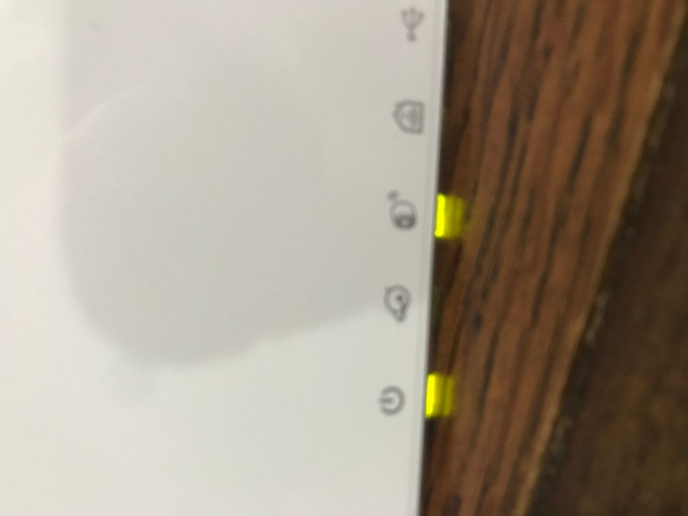

Bought them online on eBay a few months ago and I just re-synced all of the cameras to try that and now the base station will not connect to internet (?) I’ve tried resetting my own router, unplugging Ethernet and power cord and back on so how did I lose the base station now? The green light won’t come on and all the cameras are down in the app because it says base is offline

The lack of the Internet light says the base doesn't even see the router. This can be caused by a bad port on either the base or the router or a bad Ethernet cable. At this point you have nothing to lose so try the reset button on the base until the LEDs flash amber. If you then get the green Internet LED, remove all devices in Settings, My Devices. Use the Add Device button on the Devices tab to reclaim the base. Sync the cameras.

Well I think it isn’t a bad Ethernet cable because it’s brand new, worked fine and the base was connected well for a while, it’s just strange because only when I tried to update firmware did my perfect new 4 cameras that had been functioning fine, all of a sudden went down and then when I try to RE-sync the base goes down and won’t come back online for nothing - that’s not a bad Ethernet cable - that’s buggy firmware imo and so I need to find someone who can fix it? Any references for a place that may be able to offer some tech help to see the base in person maybe?
