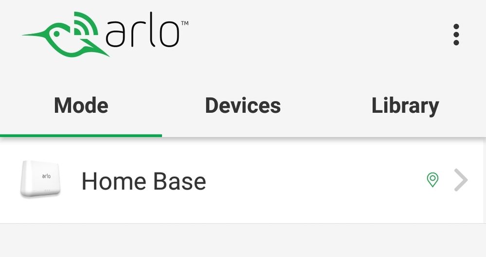

or when you open the APP no MODE is present, only the GEOFENCING pin can be seen. In this situation, no cameras are active, even the camera which should be active 100% of the time under either HomeDay or HomeNite.
When I go into the APP and change it from Geofencing to Armed, and back again, or back to schedule. This fixes the issue and the correct mode shows and the cameras work. But this should be automatic. From what I can tell, the automatic routining of switching from one mode to another is broken. This includes detecting when the mobile is moving out of geofencing range and in again, and when scheduling is changing. Manual reset it not an appropriate solution. I can confirm this has happened multiple times each day since purchase (2 days ago). Any solutions would be useful.

The app on my phone shows the mode is incorrect. E.g. the App says it is on NIGHT mode but one of my cameras is inactive as per DAY mode. i.e. the cameras are being turned on/off correctly by the base station, but the phone does not register this. I DO NOT know if this is what is tripping geofencing?
