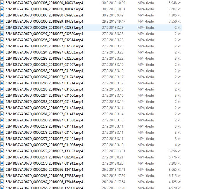

I have had similar kind of situation. At my local USB recordings there is fully function videos recorded before and after this series of 1-2kb hidden files which I´m not able to open. Is it possbile to have more informantion on somehow what is content of these files ? Are these for example motion detection or some general system infromation ?

Really sorry for my late reply. Yes, my USB recording works generally well as far as I know. Content and purpose of these hidden 1-4kb recordings interests me. This kind of recordings have happened 2 times lately end of last month. There is series of few kb files whin in few minutes which I´m not able to open. Are these movement detection, corrupted videos or something else ?

message #11 of Devisom: In my case, these files is records while motion detected
