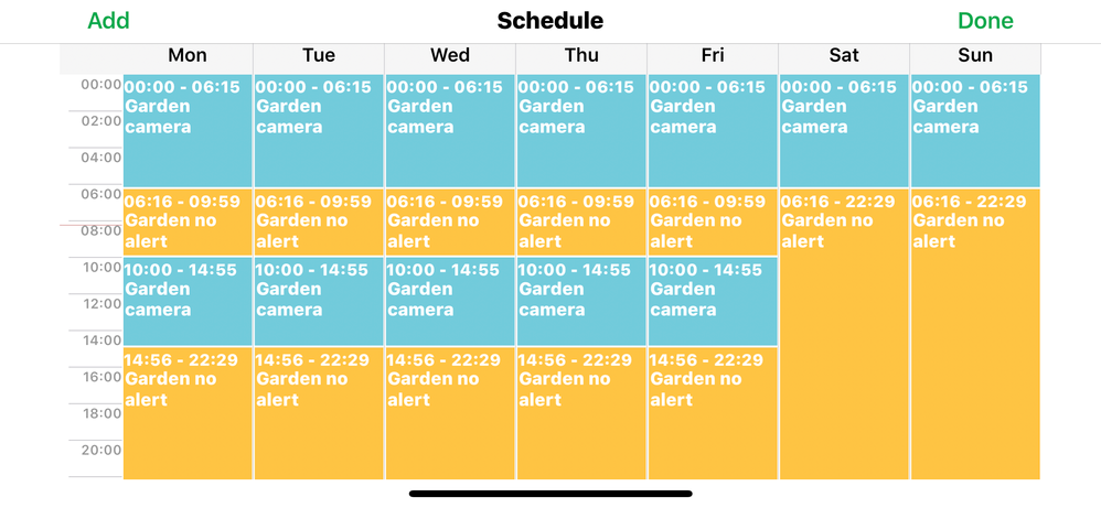

I am having trouble with custom modes and schedule mode.
I have set up two custom modes to monitor my rear garden.
First called garden camera - set to be triggered by motion and to record video then send push notifications and email. The second called garden no alert - set to be triggered by motion and record but not send notifications.
The idea was to continually monitor my rear garden but only send alerts when no one should be at home.
The issue I am having is that the custom mode has a mind of its own. It sends me alerts when it is scheduled to be in no alert mode. When I activated it today in schedule mode it was showing as disarmed. Disarmed isn’t even part of the schedule.

It may be that your schedules do not fill the time slots 100%...
the schedule will show a DISARMED and a "clock" if the Schedule is armed BUT not in a active time period.
If you haven't, try to set up the schedule on a PC as I find it much easier than in the apps.

The schedule hasn’t been changed but it has started to select whatever mode it feels like within the schedule. It’s switching between deactivated (not in the schedule) and recording when it shouldn’t and not when it should.
Feel like banging my head on a wall!
Anyone any ideas?
Try recreating the schedule only using a browser. If you need to verify the schedule is working or make modifications, continue to use only the browser.
Alerts when it is set not too. Frustrating isn’t the word. Would be less frustrating to put the thing in the bin!
Before throwing it in the bin, try a factory reset. Remove all devices from Settings, My Devices. Use the Add Device button on the Devices tab to claim the base. Sync the cameras. Update firmware if prompted as you go. Rebuild your modes, rules and schedule. Takes some time but should clear out any weirdnesses.
