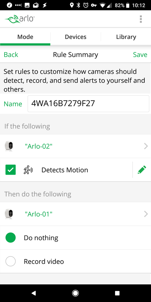

I set up a custom monitoring where if my system sets moron on my Pro3, it would capture video for 2 mins on that cam and the same on arlo2 (non-pro). Saved it and it ran fine. A couple weeks later it started recording on pro2 and Arlo 1 instead. I reconfigured and it said it was fine. Hour later it's back on the wiring ones.
Contact support and they said to delete the mode and try. I deleted it, 3 days later it reverted. By this time my ticket is closed. Wow, amazing support.
No fixed it updated and my security camera is now a baby monitor.
Very disappointed but it's an investment now. Anyone have any ideas for a pet food in the original functionality?

I was going to add multiple screenshots but looks like I can only do one.  In the attached, I keep changing the name to "Pro-03" so I can see it at a glance but I've also tried just leaving it alone.
I change the top option from "Arlo-02" to "Pro-03", leave it at detect motions.  Hit "save", not 'back'.
I change the "The do" from Arlo-01 to "Pro-03" and hit save.
Hit Save for the overall config.
Give it from 2 mins to maybe an hour and it resets right back to this config, sometimes adding in if the Cam detects sound also.
  I have deleted any other custom plans.  I have deleted and re-created this plan,  3 times.

Did you realise your rule says that Arlo-02 motion detection tells Arlo-01 to "Do Nothing"?
Nomadadon
Yes, that is what it changes to.  I had it set that pro-3 motion started recording on pro-3, or that AND motion on pro-3 started recording on arlo-1, inside the front door so I got both sides.  It keeps changing.

The only time I see this sort of rule pattern is when people don't know what they're doing and have some funky Smartthings integration. Are you using Smartthings?
Nomadadon
I do have smart things. It is however configured in a very basic mode for home (disarmed) and away only. Additionally none of this interacts with smart things and the changes of arlo configs takes minutes when nothing else is happening, changing or bring modified.
