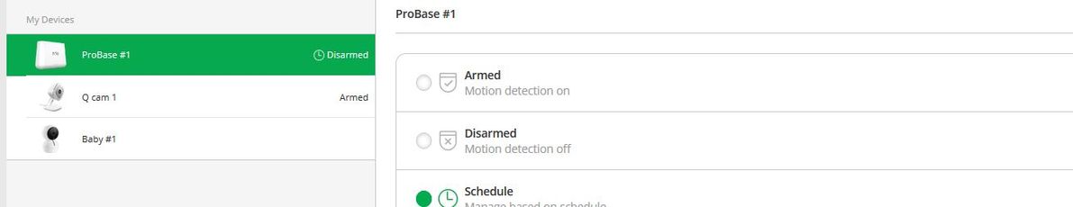

TomMac
when on Schedule... the icon should be a clock and it will say DISARMED ( if not in time set )
see pic
Uhu
Thanks again. However, this is not what my screen shows.  Currently it is daytime and I am home. Again, I set home mode to schedule (which is set to turn on lights overnight). Shouldn't my screen currently display green dot on "schedule"  Currently green dot is on "disarm." Is that ok?
TomMac
sorry, will have to recheck...will set up on phone again and send you a pic...that was from the web browser and geo not on
TomMac
On ...On android..
Mode selection brings up follows;
the camera name  .....  gps icon
if you select the camera, then it shows Geofencing active in the mode listing
Almost same on IOS Ipad... pic below showing front door , but also shows SCHEDULE if pickedgeo2031.PNG
Glad to hear... the above pic is more to what you orig ask.... Geo icon , Clock shwoing schedule is picked , and disarmed for the current schedule running
