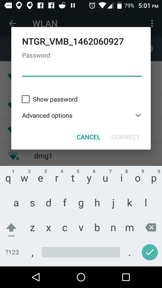

There is a password I need and I have tried my Arlo account number and the numbers on the back of my ATT Router that the Arlo Base is plugged into.

When I go to my phone settings under Netgear to connect this is what I'm running into.
I tried my Arlo Account password and the password on the back of my ATT router.
What is this damn password?!?!?!?
You're not logging into the base itself which will never happen. You need to log into your account to be able to claim the base. It's cloud-based so you're conversing with the server which talks to the base.

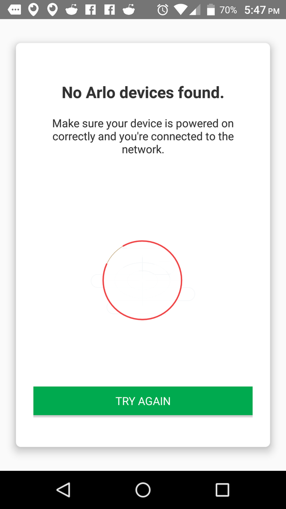

I'm STILL not online became the Arlo base isn't being recognized. Cause its not online.

Remove any devices in Settings, My Devices, if present. Hold the reset button until the LEDs flash amber and then try to claim the base.
Thank you so very much.
Excellent. Glad to hear it. Enjoy.
To clarify: Did your factory reset allow you to set a password for your base station "network"? Our camera system formed its own network (Netgear78). THAT'S what asks for a password, which I've not been able to figure out.
You should never need that password. The Arlo system should handle that all behind the scenes. Once he did the factory reset and set up the system from scratch, he should never have seen a prompt for that password.
You should also not connect to that SSID yourself from a computer. That is just for Arlo devices to communicate with the Arlo base.
