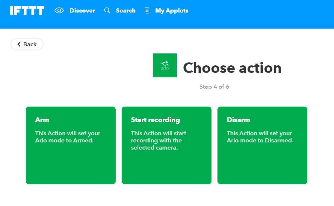

Is there a way to get any other IFTTT motion sensors to work with ARLO? Can the cameras be triggered by extenal event via a text,email,etc.?

I'm using IFTTT the other way around. When some of my Arlo camera's detect motion, a WeMo switch is switched ON to sound an alarm in my house.
I checked for you, you can have IFTTT trigger a "Start Recording". So if you have a motion sensor that works with IFTTT, you could set it up to record video that way.

--> I checked for you, you can have IFTTT trigger a "Start Recording". So if you have a motion sensor that works with IFTTT, you could set it up to record video that way.
Is there an option in Settings page to trigger cam via IFTTT ? how to locate it?
My internet speed is good. 250mbps downlink / 15 mbps uplink.
No, it's the other way around. You can setup an IFTTT recipe which can "Start recording" on the Arlo channel.
How does the interface looks like on arlo side?
There is no "Arlo side". You configure everything on IFTTT. If you have some kind of motion sensor that is able to work as a trigger in IFTTT, you can set your IFTTT recipe to "Start recording" your Arlo camera. In IFTTT the "THAT" (action) looks like:
