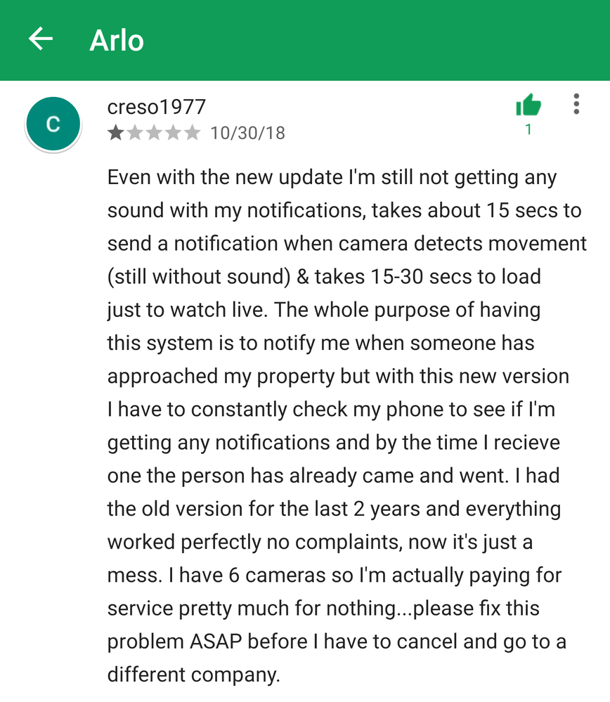

Just an update, I got a new phone (Google Pixel 3 XL) and this issue still persists. I've dealt with it by cancelling Arlo Smart because the basic notifications work just fine. I've also checked the Google Play reviews and immediately found two other people with this issue. Customer service here hasn't been of any help for months. I've attached a screenshot of a review that reflects my exact issues.
