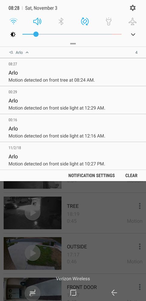

TheCausey
I am also getting delayed push notifications. Happened about a month ago. Some notifications happen right away, others take 2 minutes and i have had notifications appear around 10 minutes later. Tried reloading app, then had to fix the multiple alert problem, tried resetting the modem and router, then the base station. Still a problem. Good thing my ring doorbell works consistently and fast.

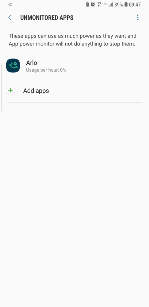

TheCausey
I put the app in my settings to never put to sleep last night and still received my push alert 3 minutes late. Also I never used arlo smart

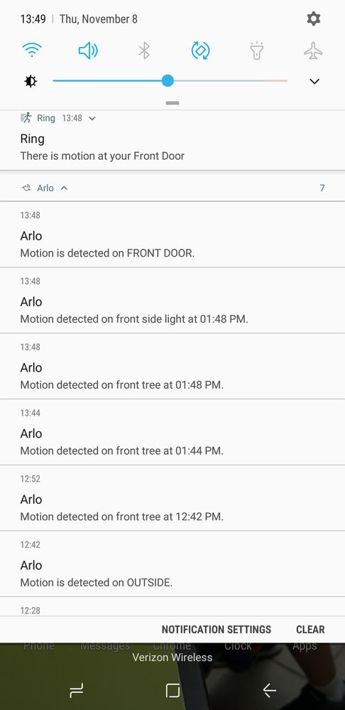

TheCausey
What happens if you trigger a recording/alert while the phone is awake?
TheCausey
If on the phone, it would trigger immediately. As seen on screenshot from 1:44 to 1:48 pm and a 10 minute delay when triggered at 12:42. Ring motion alert instantly as always awake or not.
