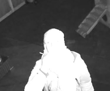

When my arlo at night takes a night vision capture of a person at my door, the person is totally overexposed therefor you can't even see the face, cause the person is totally overlit.
I tried to change some of the brightness settings, but I only see a change there at daylight. (then the picture is perfect)
anyone has an idea what I am doing wrong, cause when I google I see much better night view pictures
Do you have another camera to swap around? It may be that one camera. It can also be the distance, if you can move the camera back a few feet, it may help. Also, if the rest of the view is essentially black, the autoexposure wil try to brighten the whole scene. The picture you provided is cropped so we don't know what the rest is like.
