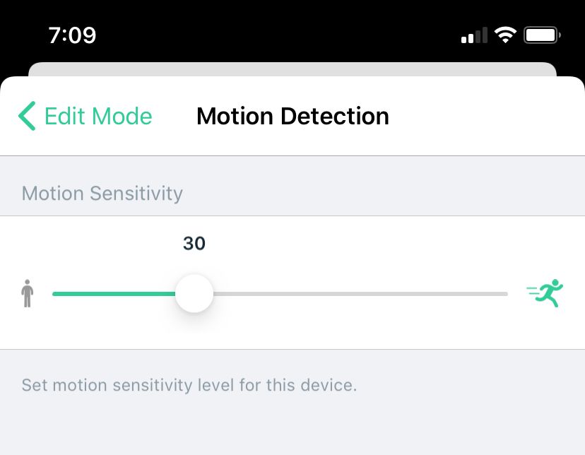

Hi. I recently moved to a new house and mounted the Arlo Pro camera on the porch. A little change of the lighting caused by a car moving by the house causes the camera to detect motion. I already cranked the motion detection sensitivity down to 30%, but I still receive 5-10 false alerts a day. Can anything be done with that?

BTW, make sure you are adjusting the SENSE level in the arming MODE, not in the settings test area
Then when you do adjust , lower about 2% at a time and test so in the end you get max detection without a lot of false triggers.

Hi!
Yes, I believe I have the sensitivity set correctly.

Most of mine run about 90% setting... only in bad wind do I use a lower 75% setting ( custom mode )
At 30%, It just seems to low to be effective to capture people ( like you said ). Was thinking you get to about 75% or more for a sweet spot.
