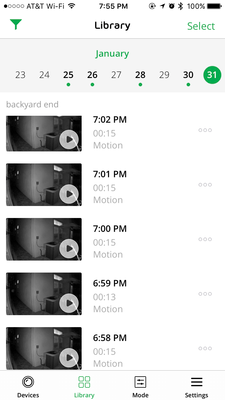

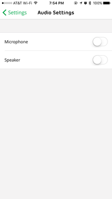

And back to James -- I turned off audio everywhere -- turned off the Modes setting (see my previous screenshot), also turned off device setting (see screenshots below).
It didn't help. As soon as I did a live view in night vision, I got at least 10+ false alarms.
