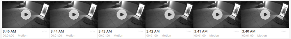

On one of my Arlo Pro camera's, after I view a live feed, I immediatley get motion detection alerts for that camera that happen every 2 minutes until I disarm the system. I can arm it back up again with no issues but as soon as I pull up a live feed of that camera, the false alerts begin again. They are all recorded to my library. I have to delete all the recordings and emails and put up with all the push notifications until I can disarm the system. Has anyone had a similar experience or know what might fix this issue? I have moved the camera and played with the motion sensitivity but think this problem may be more complex than that. Any idea's would be welcome. Thanks.

After A conversation with customer service, this seemed to fix this issue, at least mine. The CS rep had me lower the sensitivity to 1% and place the camera in a drawer. Then turn on live view. Then return camera to normal and reset the sensitivity to normal (85% in my case). I haven't been able to replicate the problem since. Time will tell if this is a permanent fix. By the way, my retailer BB would not accept a return on just one camera. They wanted the whole system returned. I figured I'll try this first. Good luck.

I too am experiencing the multi-false alarms after going back to sense mode from being on Live Feed. And for me, this is only on 1 of my 5 cameras and only happens at night, with the Night Vision setting ON. My fix is to disable the camera, then immediately enable it. That stops the typical 4-5 false motion detection alerts I would usually get.
After reading other posts on the subject, I agree perhaps a firmware tweak is in order relating to the IR sensor functionality when coming off of Live Feed mode.
