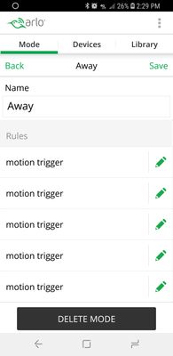

Back when I got the system in May 2017, in the armed mode and also when you setup rules in your custom mode you used to be able to name that rule whatever you wanted. I see now that you can't edit the name of the rules anymore. The modes and rules are all about customizing your experience, but they remove the ability to customize or change the rule name. Defies all logic.
So now the rules auto-name themselves "If motion on camera 1" or "If audio on camera 1" depending on what options you choose in your rule. So the other day I install my new Pro 2 outside, edit the rule that automatically appears in the Armed mode and it's working good. Next day it's quite windy and I'm getting false alarms so I go in the Armed mode to edit the rule to turn the sensitivity down and I see my rule has now, all by itself, changed its name to "motion trigger". Not only that, but audio detection was now turned on. I did not have audio on, it turned on all by itself. I figure the rule is corrupt so I decide to make all new custom modes and rules.
I create an "Away", Away Windy", "Home", and "Home Windy". Working good, then today I go into the Modes just to check things make sure it's all still good and now EVERY rule in EVERY mode is now called "motion trigger" and audio detection got turned on automatically for the Pro 2 camera in EVERY rule that it was used in. WTF!!
Anyone seen this before? I rules seem to be working, they are just all named "motion triger" and audio detection keeps coming on in the Pro 2 rules.
Anyone? Any ideas what's going on here. I rebooted my phone, rebooted base, no change.
See image........
Signed into the arlo website and all my rules in the modes are named correctly. They only display wrong in the android app. This started after the recent app update. Since the arlo website was correct I tried to fix the arlo app....

I'm not sure why it happened, but I fixed all my rule names. You have to sign into your arlo account on the website then fix the rules names there. Once you fix them on the website the app will then show them correctly as well. Since I fixed the names they have stayed correct for several weeks now. I think it's a bug in the app since the website works fine.
