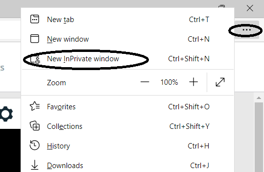

With Chrome, you just click on the three dots on the top right of the browser.
The same with Edge:
FireFox and Safari have similar controls.
