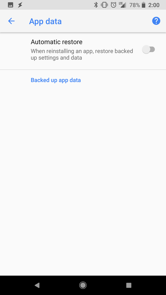

Ok, maybe you can tell me what I'm doing wrong as it still isn't working, just adding more notifications. Here are screen shots to confirm i'm doing it right. Unistalled
turned off app data
turned off backup
no backups in google drive
I just did all of the above, re-installed the Arlo app, did not even turn any of the back ups back on yet, but still getting multiple notifications again. This is extremely frustrating, i'm about to delete the app and throw the unit in the trash.
