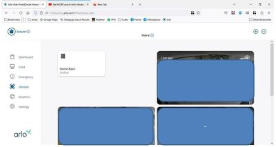

I am trying to cross trigger cameras, but no luck after looking at FAQs, manuals, and youtube videos.   My main menu does not have a "mode" setting as shown in many tutorials.    I can go to "routines" > "modes" > "arm away" and see my devices & add a rule.  When I select a camera, it offers several options including push a notification, trigger a light (if I had a bridge) or trigger the siren, etc.
Nowhere do I find an option to trigger another camera.  What am I missing?
Equipment includes VMC3030 and  VMC4030 cameras and VMB4500 base.  No subscription.

I have only had the system for about a month and am using the my.arlo.com web app.  Does this keep me from cross-triggering the cameras?
do2things
I get as far as the rules > select device > add an action . . . but the menu does not have a triggering option even though the manuals and instructions say my cameras have this capability.

Under the old mobile app experience, the web app reflects the old app that allows you to cross trigger cameras.

To help some more you may want to look for a button saying add device when editing the camera rules for what other device you want to activate. This usually points you to the  devices list that should also show the other cameras. I can’t point you closer since I refuse to upgrade to the new app experiment until arlo pulls their finger out which I expect will be EOL for my camera’s anyway.

I have it working!  It turns out the web app and the phone app are slightly different.  I was not able to set it up on the web, but got it to work using the mobile app.   Now the camera with the best view is triggered by a camera with the best proximity detection.  Thank you.
