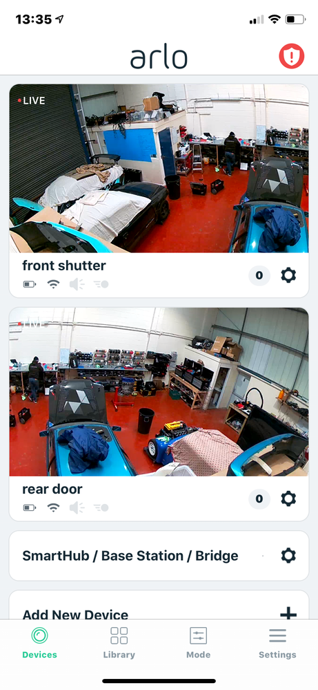

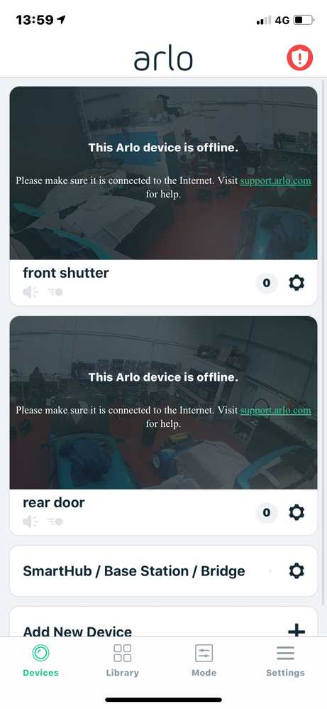

I keep having an issue with my arlo cameras, where I check the feed and they are offline. Very concerned as they are down approx 50% of the time I check. The base station is always online, so I know the internet connection is good. I’ve tried all the suggestions and troubleshooting, but they seem to just come back by themselves.

@racingcircuits wrote:
There are 3 cameras on the system, and when 1 goes down they are all down. They either all work, or none work,
This suggests that the issue is with your base station. The next time it fails, can you check the base LED status and tell us what it is? https://kb.arlo.com/000039100/What-do-the-LEDs-on-my-Arlo-SmartHub-or-base-station-mean

When the cameras are showing offline the Internet is solid green, whilst the camera led shows no led.
I’ve reset the base quite a few times, following the procedure you’ve outlined. When it comes back it’s almost as a virgin unit, so parameters have to be reset, cameras re-linked
That’s his I e
Please contact the Support Team to further investigate this issue. You will find several options for contacting support in the provided link. Arlo Tech Support
