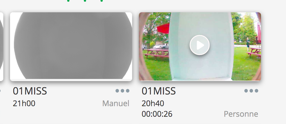

Hello, on of my arlo camera live images turn faded gray in daylight. I tried to restart the base, turn on and off the camera, turn on and off the night view (its not that because its really faded and blurred)..

Hello! I have 2 Arlo camera in the same area. One turns faded gray today in daylight. I tried to desactivated the camera without success. I also tried to restart By base withour success.
I have a second camera nearby and it work fine.

WHen does it turn gray? Is there any time at which the camera sees/records properly, even if only for a short time? Give us as many details as you can think of.
Yes, I have the footage whe it shifted, at 14 seconds. The guy in frint the camera is a friend and He was just changing is position on the seat and then it all faded.
You can see it here: https://my.arlo.com/hmsweb/users/library/share/link/B264983E57339637_201906
First step, try reinserting the battery and removing the camera from Settings, My Devices and resync. You'll need to re-enter any settings and camera rules in your modes after doing this (the Armed mode will automatically get a rule). If that doesn't help, open a case with support for a possible RMA:
