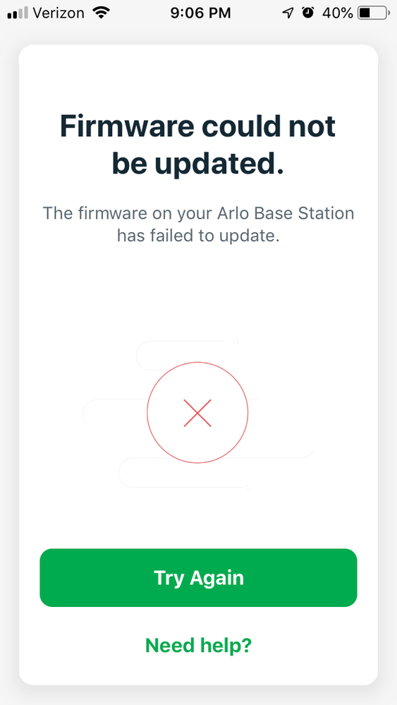

Base firmware 1.12.2.2_2754 will not update
Didn't see that this time. I use the web app on computer. I still think the updates should wait till we say ok since it stops the alerts. Today was second day I awoke to find cameras are stopped, waiting on the base to update. Never acceptable for the alerts to stop. Defeats the reason for pay so much for a system. I've had enough problems with this system, that if I had to do it again, I would not have bought this one. I bought it because I have had quite a bit of Netgear equipment on my network, and all have been good. This system stinks. Since it connects to you, it takes a while to start live (if you don't have super fast internet, which I can't get). I would have been happier if it had a setting to only record locally.
I am Having the same problem. Base Station Firmware will not update after pressing - Update Base Station . Looks like POOR testing by some at Arlo. Trying to update from 1.12.2.2_2754 to 1.12.2.2_2762.

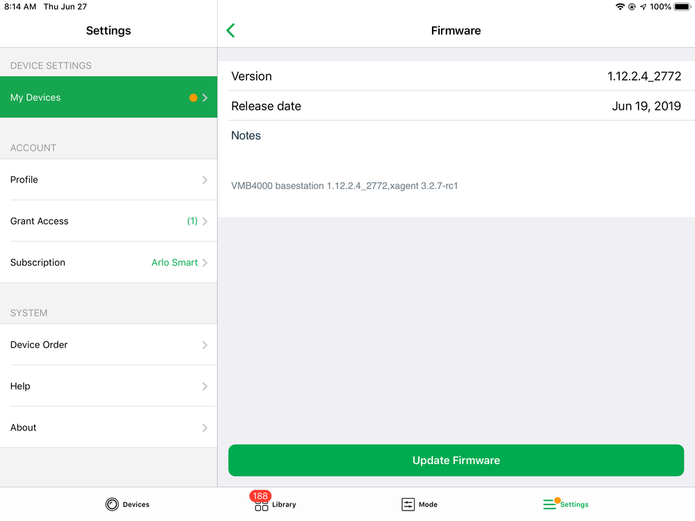

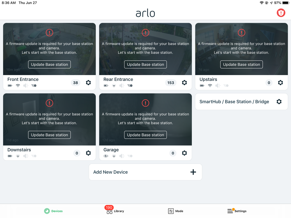

A firmware update is required for your base station and camera.
Let’s start with the base station.
Are you sure you want to update to 1.12.2.4_2772?
Firmware update is in progress
FW Version 1.12.2.4_2772
Firmware Update is available 1.12.2.3_2762
HW Version VMB4000r3
Serial Number 4R036C7DA34E6
Notes: VMB4000 basestation 1.12.2.4_2772,xagent 3.2.7-rc1

Woke up to check my Arlo cameras and find the base station VMB4000r3 asking for updates repeatedly and cycling between 1.12.2.4_2772 and 1.12.2.3_2762
Am unable to view cameras 😵
Checked the web site and found 1.12.2.3_2762 was the latest release. Has the Arlo update mechanism been hacked?
