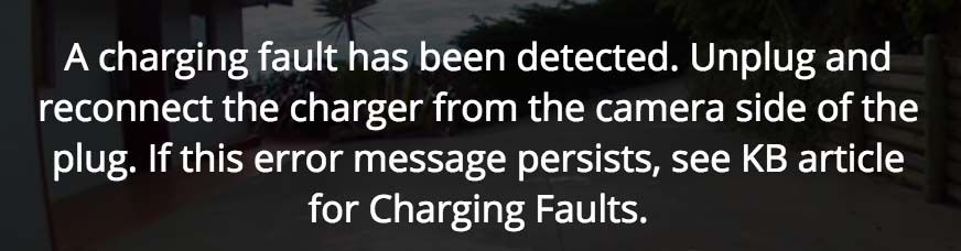

On the lastest two that we just purchaed this last November 2017 they now are showing charging fault, and the message tells me to check the KB article but does not tell me the actual KB article number I am to look for. Not very good for an error message in my opinion. The KB article number in the charge fault message would be a big help.
Until recently all four of the solar panels have been charging properly given the position I have them gives each approximately 8-9 hours of full sun each day and another 3-4 hours of partial sun. My problem is that I was suspecting a solar panel charging issue as many have indicated here but I grabbed my ladder, took the camera down, then plugged it into the factory indoor charger that came with the camera kit and even though the camera shows the battery charge symbol, there is still 0% charge on the battery after charging overnight. Kinda seesm like a battery issue to me. My next step though is to swap battery with anther camera to see if the fault follows the battery or stays with the camera. I am hoping it is just the battery and not a bad camera. I am opening a support case to see what they say or recommend.
Ricochet1,
Consider the following:
-disconnect the power cable from the camera and the solar panel
-open the battery compartment door and remove the battery
-replace the battery and close the battery compartment door, be sure the door is closed tightly
-reconnect the charging cable to the camera and the solar panel, make sure the connect is tight and secure
-check your mobile app to make see if you experience the same error message.
