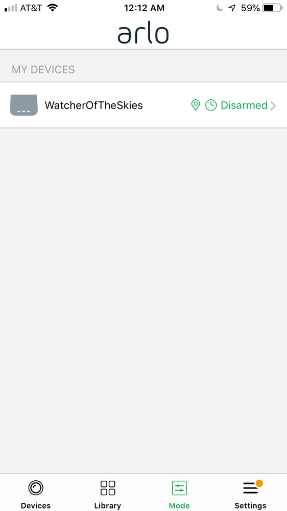

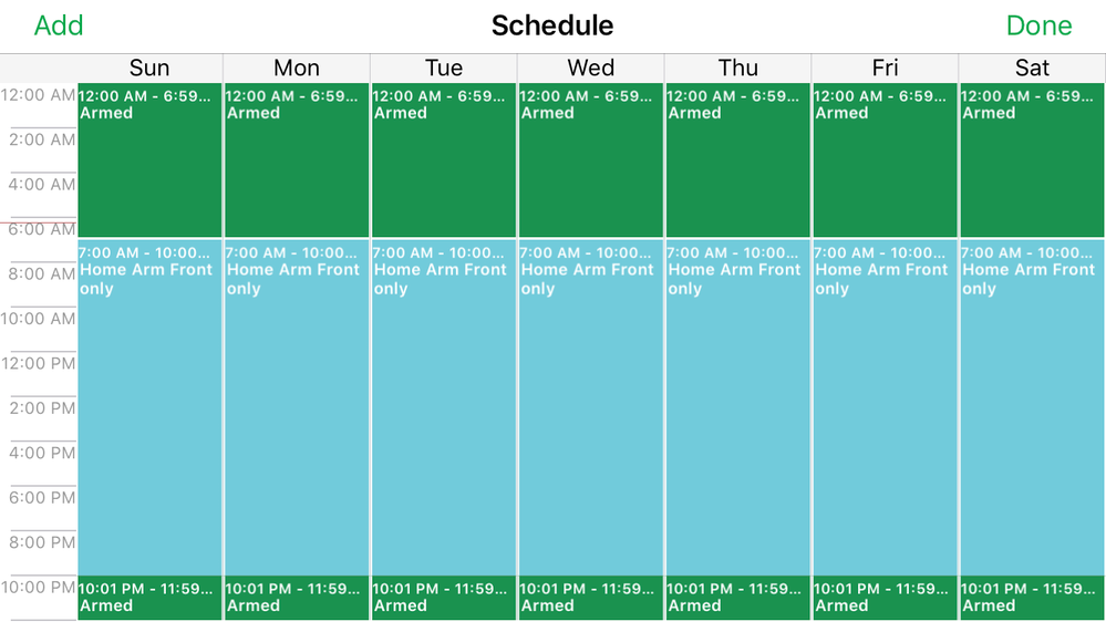

It looks like geofencing and schedule isn’t working anymore. I have home mode set to schedule but it seems that My 12:00am to 6:59 am “Armed” part doesn’t work, the other two daily schedules work fine. I’ve rebooted my base, no luck.
I’m using iOS and I’ve reinstalled the app on my phone as well.
Hey Nanceeg,
When you say the 12-6:59 am armed schedule doesn't work, does the system go to disarmed or is it armed but not receiving recordings?
Also try checking on the web client on the computer to make sure that the schedule for 12-6:59 am armed is showing up.
What I would suggest is to delete everything on your schedule (check on both on the Arlo app on your iOS device and the web client on your computer to make sure it is all cleared off) and reboot your Base Station. After rebooting your Base Station, try to set up your schedule again whether it's on your iOS device or the web client and see if that helps.
Thank you! I created a 2nd mode and that seems to have fixed this issue for me, too. Don’t understand why it won’t use the same mode twice in a day, but at least I can get it to work.
