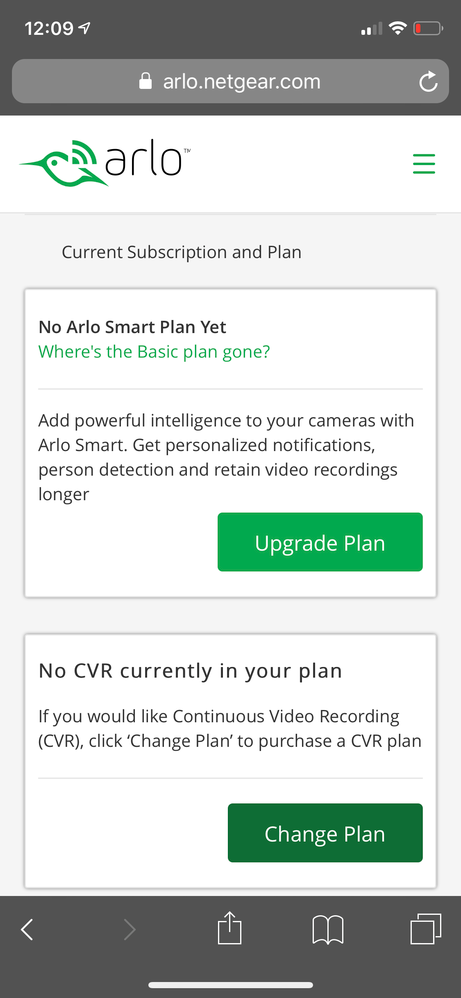

Hi @cad0914
the Arlo development team is investigating reports on the inconsistency between the the app and web displaying a Smart subscription when users are currently on a basic plan.
