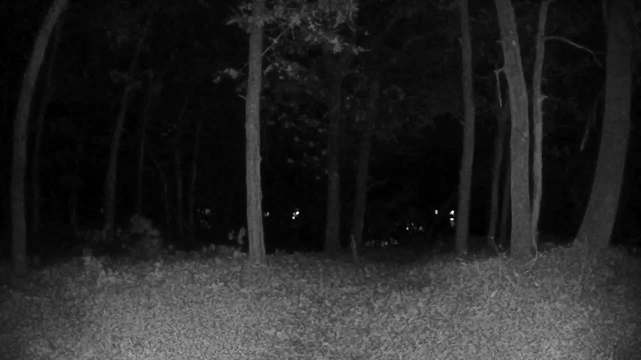

Here a night vison shot outside from ARLO(small stump is 25'+ away in center);
Here is the PRO at same location;
Agreed - my Pros have a much better night vision than the originals. I had to reset my base yesterday for testing and it seemed like night vision wasn't on so I toggled the setting to be sure. WOrks fine now.
Yes, the night vision is turned on. I turned it off and on a few times. I will remove and replace the battery and see if that works. Your photo comparison is great. I'm hoping to get similar results. Thanks.
