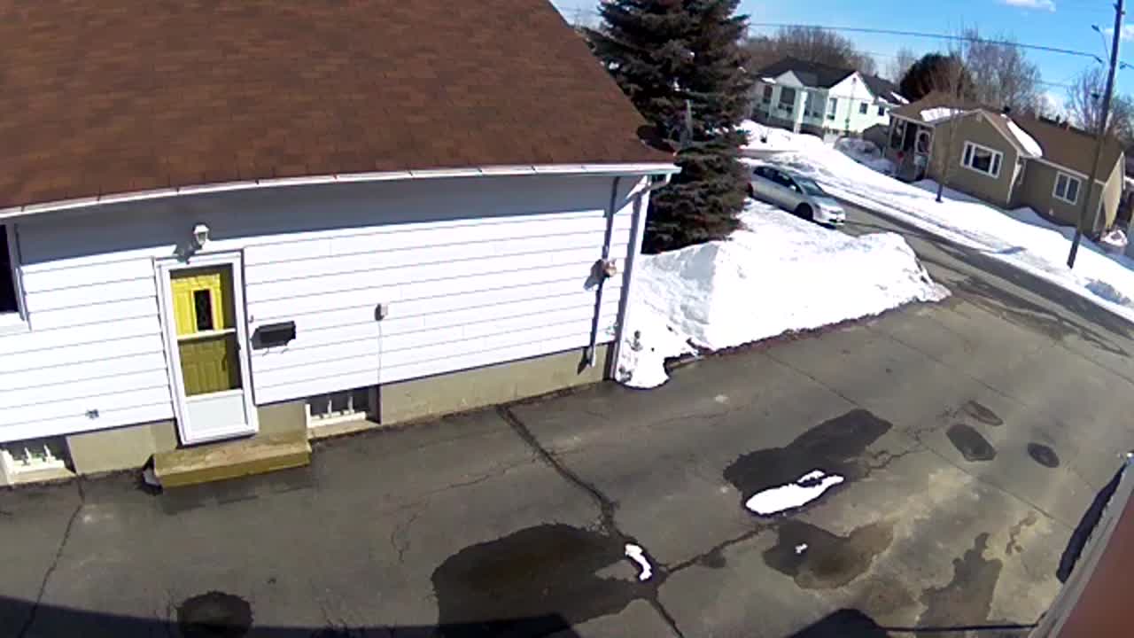

TomMac I can't lower the angle anymore than it is due to the height. I need it that high for theft reasons. My only alterative is to spend more money and buy the adjustable wall mount. It's set above my side door entrance. Anymore adjustment on a lower angle it will pick up movement at my side entrance which I prefer not to have. It's the distance and sensitivity that has me stumped.
can you snap shot a pic ?
If you can't move, then the only thing at this time I can think of is the Rube Goldberg method ( actually not that bad ) where someone crafted a lens hood from pvc and painted black to change vision of shot
I'll see if I can find it
edit
edit
Camera above my side entrance.
Is that a window above the camera?
If so and if it was me, I would mount closer to the window and run by constant AC then you could angle it down a little more
I broke down and bought a camera arm. I moved the camera under the window so I can reach down and take it in for a charge. Still trying to get a good adjustement so it doesn't pick up moving vehicles from the road.
Thanks for the links TomMac but buying it for 23$ was less of a hassle than using my fuel and paying for pipe more than I needed and spending the time for a cut and fit.
