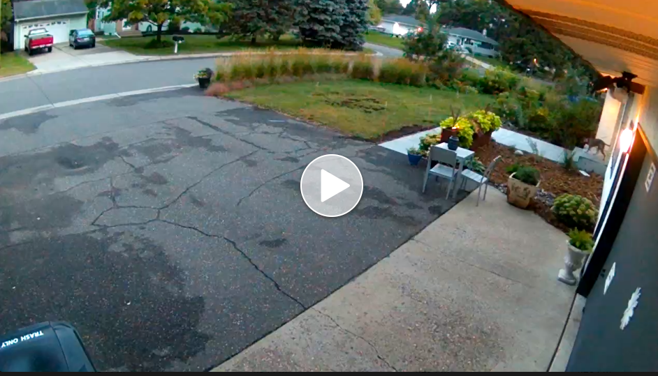

I have the Arlo Pro with 4 cameras, and the system had been working great. however in the last 48 hours the camera covering the driveway and front half of my house is missing almost all motion. It barely catches the cars driving by or people walking and biking like it used to. My system is set to armed, and the running man is black and it is set at 80 like it has been. All the other cameras are working great, but of course one of the most important is missing everything. Appreciate the help.

You can add me to the list. I used to get motion alerts for cars driving by on the main road, including the mail truck. Now nothing. Something has to be in the middle of my driveway for anything to get picked up.
It will also capture movement right at my front door, but not anyone approaching the front door on the sidewalk, which is closer to the camera. Not sure how Netgear tests these updates, but they keep getting worse.
