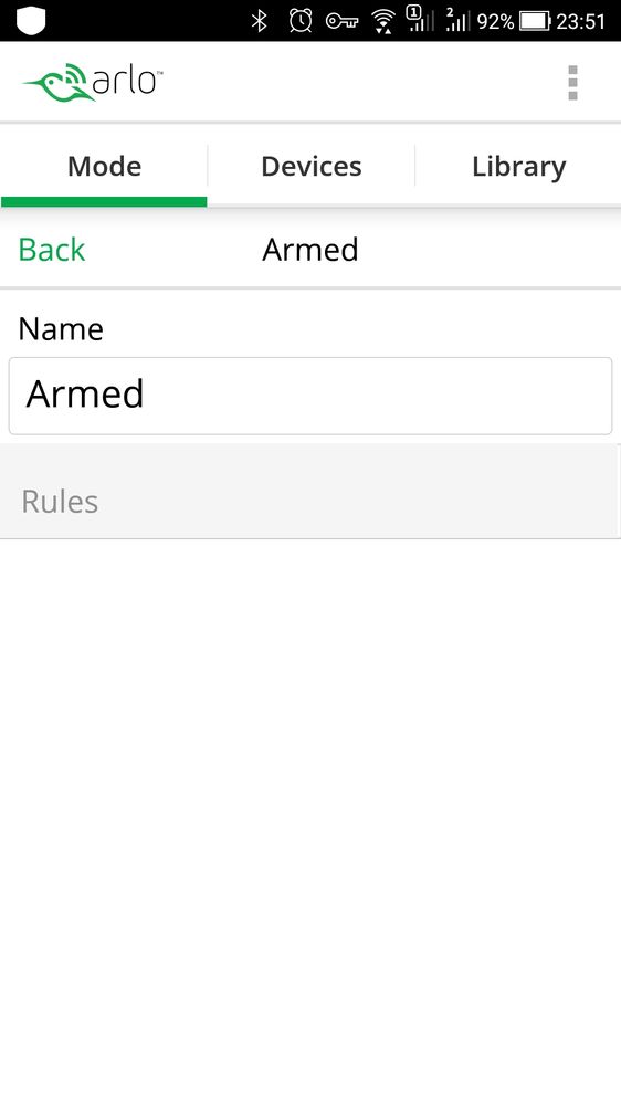

My default armed mode doesn't arm, even if I manually arm it. If I try to edit the default armed mode there is nothing inside it, no rules to edit, no mention of which cameras its using, no mention of duration, nothing, its just blank.
That is only on the Arlo Pro base station though as my original Arlo base station is fine with the default armed mode and also my Arlo Q is fine.
I was told my DawnM that the developers did allow users to edit the default armed mode, but then they decided against it and revoked permission, so the default armed mode should not be editable and should arm ALL cameras connected to it. But personally I don't get the logic of that.
I have Arlo Pro base station and original Arlo base station and Arlo Q too. Its only the Arlo Pro base station that has that issue.
(See attached screenshot)
I agree with them that defaut armed mode should not be allowe to modify. It works like amaximum mode. If you just want to detect/record only certain cameras then customize your rules. Default armed mode is perfect for being away from home for a period of time.
That is beside the liability issue. If it's armed mode, everything should be armed.
Armed mode may not always include all active cameras, check yours just in case. If it does show all your cameras, then you can safely use it. Not all users are affected the same way, so yours might be ok......lucky you!
Should any of your cameras be excluded from it, wouldn’t you wish to be abe to edit the mode? So you can’t do that.......only way around it would be using custom mode(s) for arming/disarming your system.
@Paul_FCCL wrote:
Yes, default armed mode still show all cameras for me. Wow, i didnt know it's messed up for some users, too.
My guess is that problems could start while adding/removing devices, somehow the system gets confused at times and native armed mode does not update itself properly, thus the exclusion of some devices. Mine only has two of the four active cameras and strangely enough it’s still showing two inactive cameras.
Other note about the armed mode, all cameras included will always arm at default settings (ie. 80% sensitivity and 10 secs. recordings) which may not be of your preference.
