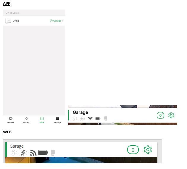

Not sure if this firmware was supposed to fix the issue as indicated in case number 40054670. When on schedule, the Garage activates from morning till evening. In the Arlo app on iOS, it shows Garage is active, but the symbol for Garage in Devices tab is grayed out. Having said this, the above issue doesnt exist on the web. The symbol is active when Garage routine is active on the web. Enclosed is a screenshot of the problem.
