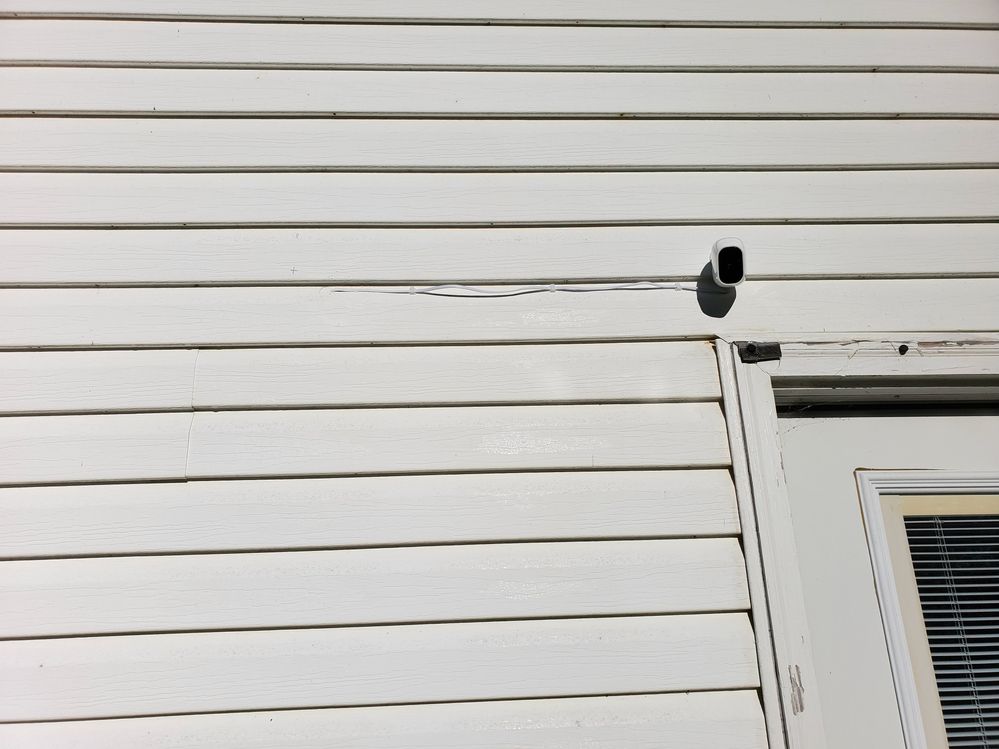

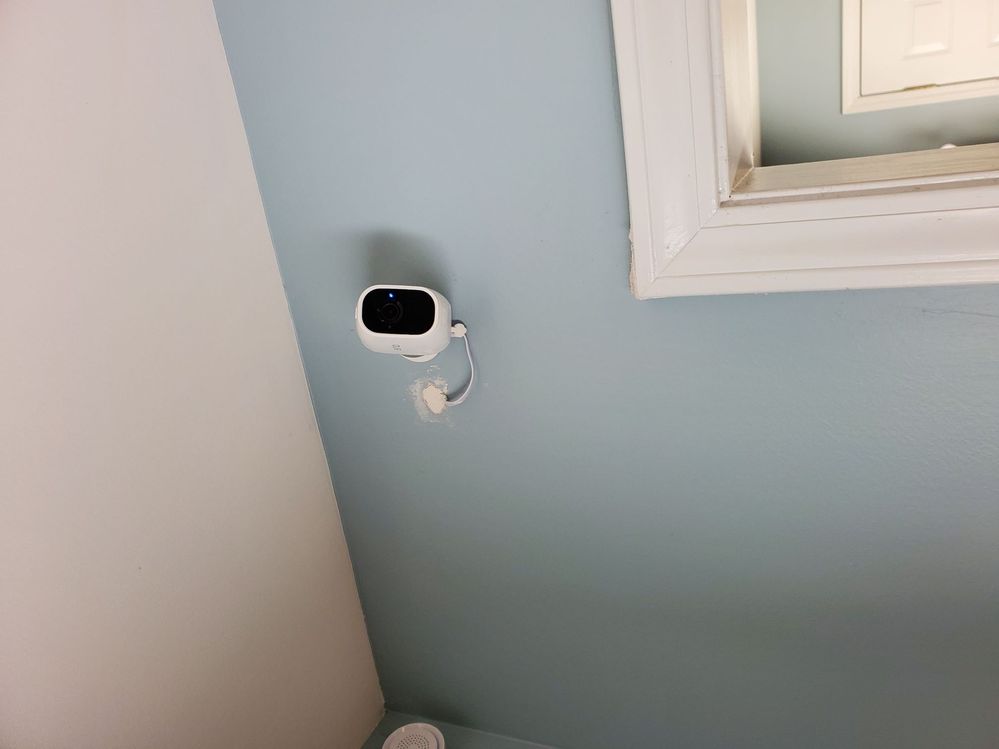

Think I have a better plan for the rest to look better than this. (I need to now paint that spot seeing to fish the wire down the wall, i drop a piece of metal and use a magnet to pull it down the wall. Right now, I put all the camera straight into studs. I'm going to move them over slightly so then I can drill that large hole under the part that holds the camera to the wall. Maybe ill do it to the camera in the pic so they all look the same. Although my wife thinks I care tok much about how it looks when done. But, I want it to look professional and clean.
If using a regular usb cable on the outside cameras to feed power, make sure that you somehow seal the usb port to prevent water intrusion ( as they are not weather resistant like the outdoor cables )
