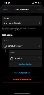

I have spent countless hours on the new app trying to schedule an individual exterior camera. I am trying to get it to go to standby automatically at 9AM and then back to Armed Home at 5PM. Any ideas? Just when I think I have it solved, the camera continues to trigger movement alerts during the day. The old app was way more intuitive. 😩
Can you post screen shots of your two automations?
KevinCx
Hi Stephen. Thanks for your prompt reply. I have also disabled Arm Away.
Here you go.
StephenB
Here you go.
These should trigger as long as the system isn't put into "Arm Away" (either manually or via a geofencing automation).
Have you double-checked that there are no camera rules in "Standby"?  (By default there aren't, but it is possible that you modified standby at some point along the way).
KevinCx
I don’t think so but I’ll have a look.  Yesterday afternoon I manually disabled Arm Away. The camera went in to Standby this morning as scheduled so I think it’s all good. By the way, am I correct in assuming that the automation scheduling will control all cameras on the same network? Is there a way to schedule cameras separately while they are on the same network? Just in case I want one on Arm Home while another is in standby.
