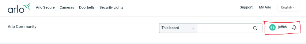

Click on the envelope icon in the upper right of the forum page.
Hmm. Is it possible that feature is not enabled for all users? That icon is not present for me:
And, voila! The DM feature has just become enabled for me. Thanks!
