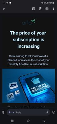

@BrookeN  @Edinburgh_lad1 @chicane @GW1a
Arlo's sudden new forced prices and billing changes are shocking / incredible, given the past year's very poor Pro4 and Pro5s product quality, product support, and customer support.
To name just a few points that are still in play:
1) Continued unresolved months & months of 5s cams not working correctly;
2) No capability of a user being able to download the 5s Firmware as they want;
3) 5s cams still won't work on base stations without their old Firmware being forced back on.
