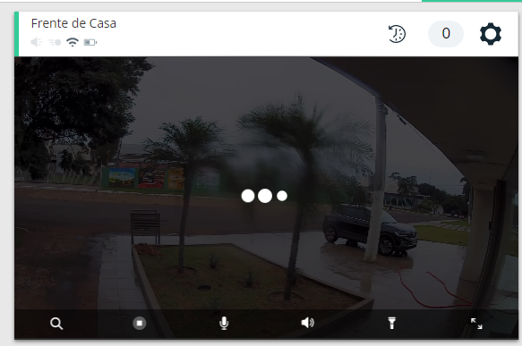

I'm having trouble monitoring my cameras. My router is an ac2600 tplink, I have 500mb of hired fiber optic internet and my camera is very bad.
I set up a repeater with RJ cable to bring the base of the cameras closer, the signal between the cameras and the base is ok, as you can see in the photo. However the internet signal is horrible, the cameras are constantly charging.
the base rj port is gigabyte? I'm thinking of buying a repeater with a gigabyte rj-port to see if it solves my problem. But it costs about 80 dollars and I need 2 repeaters, I need an auxiliary base to get to all cameras, in the end I will spend almost 500 dollars more just because the arlo is of dubious quality.
