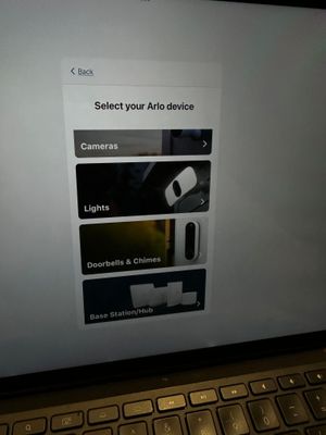

When my husband goes to try to add the fake Pro 5s and the security system are not available at all.
So how else can we force the migration?
You can see that security system is not an option. Neither is the Pro 5S
What country are you in? Not all countries currently can onboard either of those new devices. You may want to try clearing the browser cache/cookies (or use a different browser) as well as the app to see if that helps.
