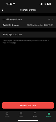

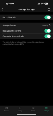

adamab
This is what I see when going in to settings, everything is activated.
Also nothing happens when I try to press the exclamation mark.

You're still using the old user interface (UI) which uses Library to view recordings while I am using the new UI that uses Feed for a long time. That means I can't look at my rules and see the same thing as you but the Arlo FAQ linked below suggests you're set up properly. I also suspect that the "!" simply means you don't have a subscription so there would be no cloud recordings. Regardless, you should be getting recordings via local storage on your hub - is that true?

Your previous images show that you have enabled motion detection and recording in your rule and audio detection is disabled. I don't understand where "the settings won’t allow me to change the rule to “record video when sensing motion”" is seen.
Also, your image of the local storage settings shows recordings happening since there are many megabytes being used on the drive according to "Available Storage".
