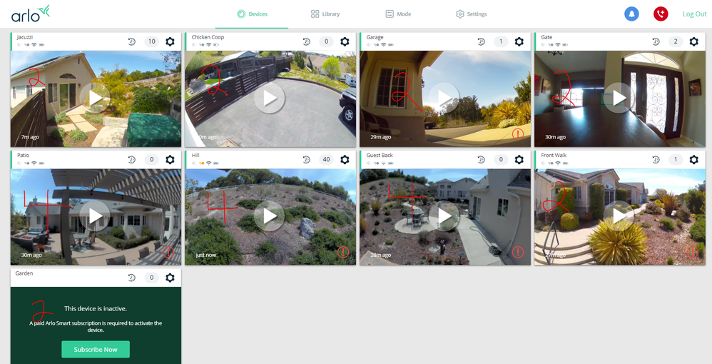

The app is requiring a subscription plan for the Pro 2 cameras, too (see attached; I marked the camera models on each view).
I added one single-cam plan because the app required a plan to activate one of the remaining Pro 2 cameras.   So, now I have a 5-cam plan with (3) Pro 4's added + (2) Pro 2's.  And a single-cam plan to cover one of the Pro 2's.   But, now it still says I need to activate one of the Pro 2's...

Got it. I don't know why subscribing to a multi cam would cancel out the free 7 day storage or require a sub on a Pro2 or even why the last cam would have went to full price. So maybe a moderator can chime in.
Community Manager
Community Manager
You mention having (6) Pro 2 cameras. Free cloud recording is only available when you have 5 or less legacy devices (Pro 2 in this case). If you have more than 5 legacy devices, you will need a subscription plan for each legacy camera.
ktm805
Yes, I have (6) Pro 2 cameras, but (2) of those are on the multi-cam subscription I bought to cover my (3) Pro 4 cameras.  So, I only have (4) Pro 2 cameras without a plan.
Community Manager
Community Manager
ktm805,
The number of legacy cameras with a plan is irrelevant in this case. The total number of legacy cameras on your account is what matters. If you have more than 5 total legacy cameras, each will need a subscription plan. You can have a maximum of 5 legacy devices before needing the subscription.
