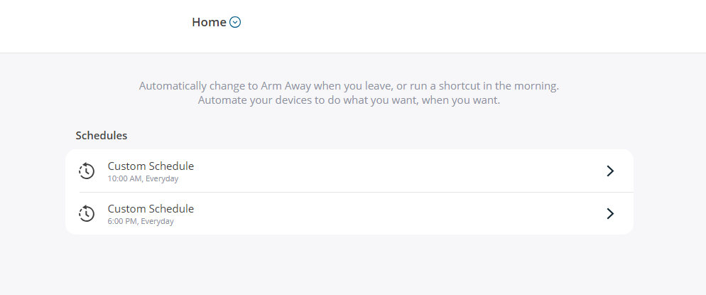

PlumBluett
@ShayneS  Please post more about the automations that become disabled or turned off. My 4k Pro Cameras do not include a hub or base. I cannot get the automations to stay saved and executing. Once I logout of my profile account (the owner account), one or both automations become disabled and do not execute.

PlumBluett
This schedule disables itself, I come back and it has not executed and it is disabled all the time. Home Automation Task Detail.PNGHome Automation Task Overview.PNGHome Automation Schedule.PNG
ShayneS
@PlumBluett When you mention disabled, Are you not receiving notifications? Can you define disabled in this scenario? (You do not have Secure subscription so you will not receive any recordings to your feed only standard push notifications).
I do see you have Amy Away and Arm Home setup. Which mode(s) is having an issue?
Your Device(s) are currently in "Arm Away" is this the correct mode you want from 6pm-10AM?
Thanks
PlumBluett
About Notifications: In android, after installing the app, I get background notifications of movement triggers.
About Describing "Disabled" better: When I review the automations, I see one or both modes disabled (See the picture) and then they do not execute.
About if 6PM - 10AM is for ARM AWAY mode: Yes and my ARM HOME mode is 10AM-6PMScreenshot_20240305-120935_Arlo Secure.jpg
PlumBluett
Do you think the problem is at the "ENABLED CONDITION" at the top of the automation, where I declare which modes are enabled? For each automation I declare that ONLY the incoming mode is the enabled one. Should I declare both as enabled? Screenshot_20240305-122115_Arlo Secure.jpg
ShayneS
@PlumBluett
Here is the definition for the Always enabled option: "If you would like to have the Schedule Automation only occur when your system is in a specific mode, tap or click Always Enabled to change which modes are enabled. All three modes are enabled by default."
I have a similar schedule to yours and I do not have any of the modes selected under "Select Mode"
Let's try and unselect this for both modes and test again. You can adjust the times for your schedule to test now if possible, then switch them back.

PlumBluett
It already failed at the first opportunity.  The evening automation is now shaded and disabled.
PlumBluett
At this point, I gave up on fixing the problem, I just arm home and away for all cameras all day long. Nobody has solved this problem.
