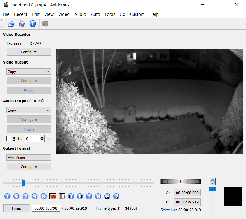

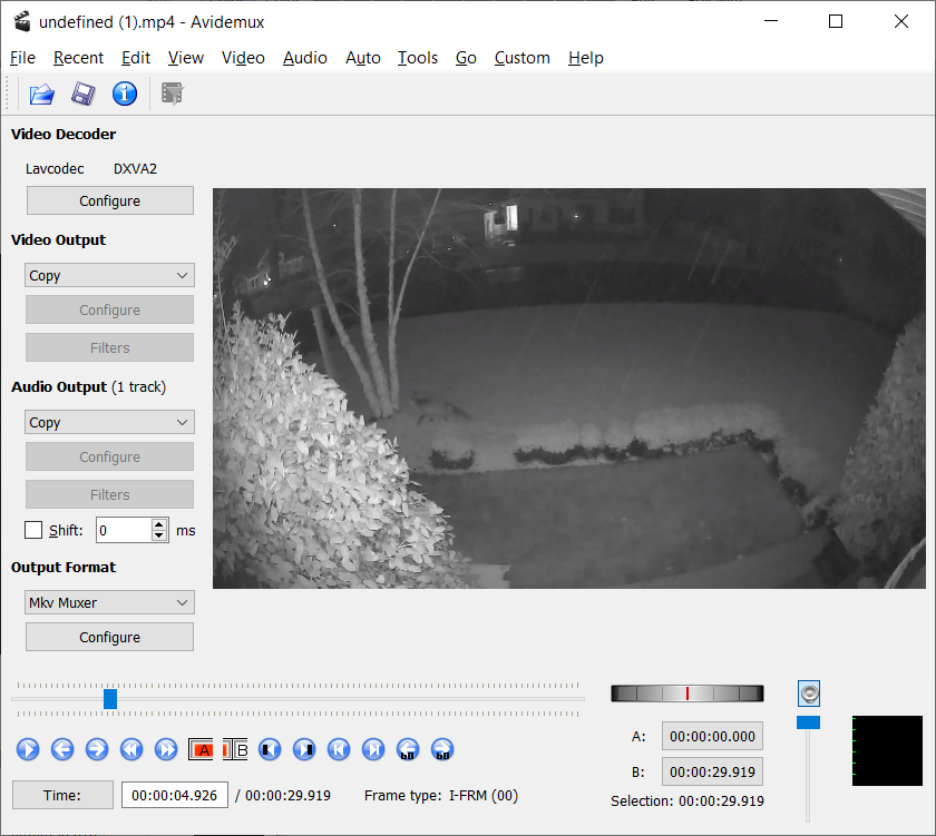

In the original (nighttime) recording, the exposure also abruptly changes at 4.313 seconds (and it looks like Nightvision is being briefly turned off at that point). Nightvision turns back on again at 4.926 seconds. This is clearly wrong behavior if low-light color vision is not enabled.
I'm using a tool called AVIdemux, which lets me see the individual frames - here are a couple of screenshots from the nighttime recording.
