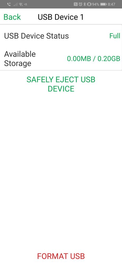

I just purchased a 2 camera Arlo Pro 3 kit with the VMB4540r2 SmartHub base station. I have a FAT32 formatted 500GB hard drive connected via USB to the hub. On my computer (MacBook pro), the drive is empty and shows as 499.76GB available capacity. When I connect it to the base it only shows as 199.99MB. I have tried reformatting it through my computer and through the hub/app. Looking for other solutions. It is an older hard drive: Maxtor Onetouch iii 500GB.

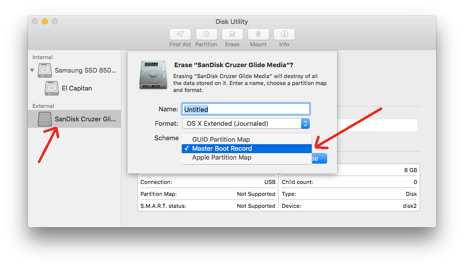

@dpl I appreciate your helpful input. My disk utility also did not show that EFI bootup partition. In fact, it showed that the device only had one partition. I also figured out that they changed the disk utility app awhile back to only show volumes instead of devices. Here is the process that worked for me (finally).
  1. Open the disk utility app (applications>utilities>disk utility)
  2. Go to view in the menu bar, then check "Show all Devices". This allows you to erase/format the DRIVE and not the VOLUME. This is crucial so that you can change the partition table or "SCHEME".
  3. If your problem is like ours, the disk will still only show ONE PARTITION at this time, however this is technically incorrect due to that partition table (GUID Partition Map versus Master Boot Record).
  4. To confirm that this is the issue, open the terminal app (applications>utilities>terminal) and enter "diskutil list" (without the quotation marks). This will show a list of all the drives that are connected. I believe that any external drives will be towards the bottom of the list. Mine looked like this:
    • /dev/disk4 (external, physical):
         #:                       TYPE NAME                    SIZE       IDENTIFIER
         0:      GUID_partition_scheme                        *500.1 GB   disk4
         1:                        EFI EFI                     209.7 MB   disk4s1
         2:       Microsoft Basic Data ARLO BACKUP             499.6 GB   disk4s2
      **Again, this EFI partition doesn't show in Disk Utility but it does show up in the Terminal app. I would advise caution when using terminal because it is a Command Line Interface and you are basically in the "guts" of your operating system. The above mentioned command is harmless, but other commands can cause some serious changes. So, use caution.
  5. The terminal app has identified the GUID Partition Map. We want to get rid of that. So go back to the disk utility. If you have done step 2 then you should see your device with the volume indented below it. The volume will show the "name" you are used to seeing while the device will likely show the Product name (Such as Device="Maxtor OneTouch II Media" and Volume="Arlo Backup"). You want to make sure that you select the device and note the volume.
  6. **If you have ANYTHING on that device or volume that you want to save then put it on another device or you will lose it. ** Select the DEVICE, then go to the "erase" button. This should show options for "name" "format" and "scheme. If you only have the volume selected then you likely will not see the "scheme" option. Thats the crucial option, so make sure you have the device selected. The options you want are:
    • Name:  whatever you want to call it, I chose "ARLO BACKUP"
      • This names the volume, even though we are erasing the device
    • Format: MS-DOS(FAT)
    • Scheme: Master Boot Record
  7. Go ahead and click erase (this may take a second to complete the process)
  8. Once this is complete go back to terminal and run the "diskutil list" command again. This should now show your device as having the correct partition scheme (mine shows as FDisk_partition_scheme) and only one partition.
  9. My drive worked immediately with the base station, but if you need to reformat it follow these steps here: How do I format a USB device for local storage using my Arlo Pro base station?

I also have a new Pro 3 system. I plugged in a brand new Seagate 2TB drive, and it also showed only .20GB of storage available, and showing Full after recording 200 MB of video. Any suggestions on how to have the base recognize the 2000GB instead of . 2GB??

I have the EXACT same problem! It shows 199.88 MB when I know I have a freshly formatted WD My Passport 1 TB drive, formatted in FAT32 GUID with no password or encryption.
I formatted it 3 times on my iMac and 3 times from the Arlo App on the base. I don't have any other partitions on it AFAIK.
Any idea?

GOT IT!
It had an EFI bootup partition that didn't show up in Disk Utility, but showed in Terminal.app with the command : diskutil list
Found the solution on Stack Overflow
https://superuser.com/questions/1001369/how-do-i-remove-the-efi-partition-on-my-usb-using-mac-os-x-1...
Format it this way :
