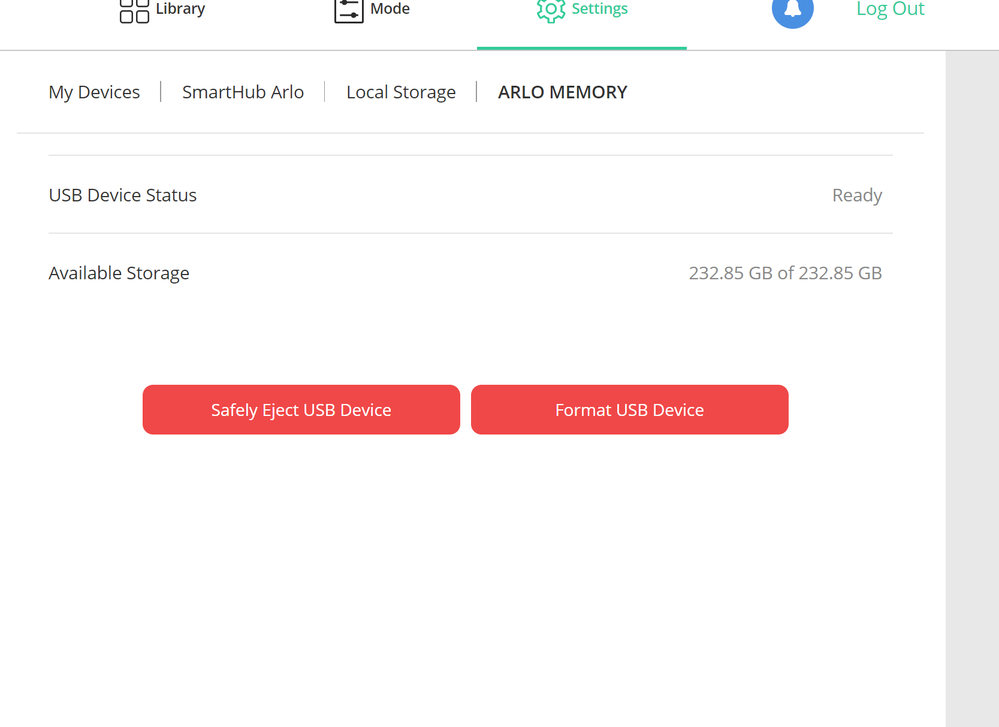

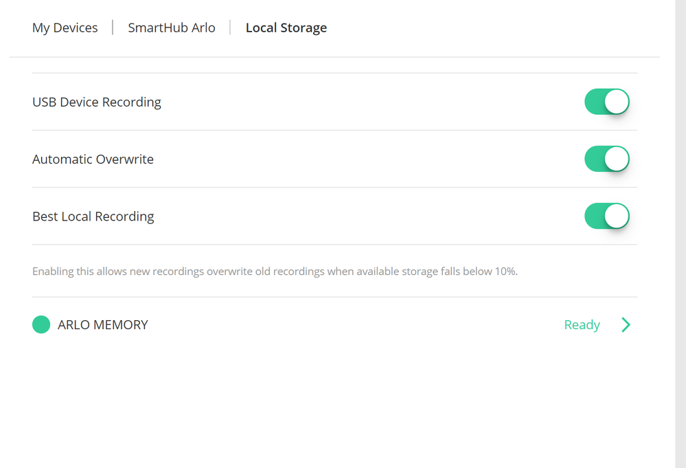

Here are photos of the two screens you requested. Any Ideas?
Second screen
Your screen shots say that the base is recognizing the USB drive.
