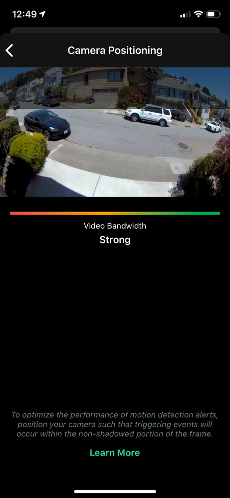

I have an ongoing issue with my Arlo Prop 3 - and support has been less than helpful
One of my cameras keeps stopping to record events - even though the base station is super close, and bandwidth is shows strong and my internet connection is ultra fast and stable
It just stops recording - once i restart base station it works for a few days - and then its stops completely again
I wonder if this is some caching / memory issue - because it happens to the front camera only - that has way more motion (street facing) vs the entrance cameral - which doesnt have that issue - and yes i have swapped cameras

A screen shot from the cam of the view could help and here is link you can try on positioning the cam since it is both cameras you have tried. The detection is is the bottom 2/3 of the view. Not sure if that is your problem but it has made a difference here.
https://kb.arlo.com/37/How-do-I-position-my-Arlo-wire-free-camera
yeah definitely not positioning - when it works it works great - every passerby, every car is recorded - and then it just stops ...cold - to never record anything ever until i restart base station
