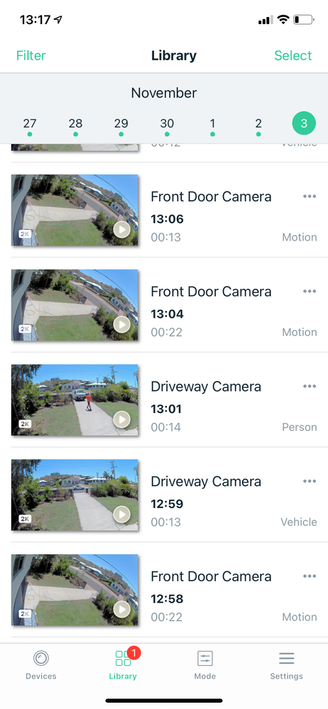

I am having significant issues with my set up. I have three cameras set up in my front yard. I have done motion detection test and camera positioning set up as per instructions.
Miraculously a mail man was able to enter my property, place a parcel on the top of stairs and motion did not start until he was half way back down the driveway to the car. All three cameras should be picking up this motion. One side placed and the others front on.
I am very confused why I am getting hundreds of notifications for cars travelling in the distance across the road etc but the important motion is not being recorded. I have checked motion sensitivity on each camera 10-100 and no luck.
This is becoming incredibly frustrating and I’m starting to think the cameras could be faulty. Last night they appeared to work perfectly and captured a few cats in my yard. Then after 6:00am I was bombarded with motion notifications of nothing happening.
Also, the video is stopping recording when motion is still occurring.
Any suggestions here?
