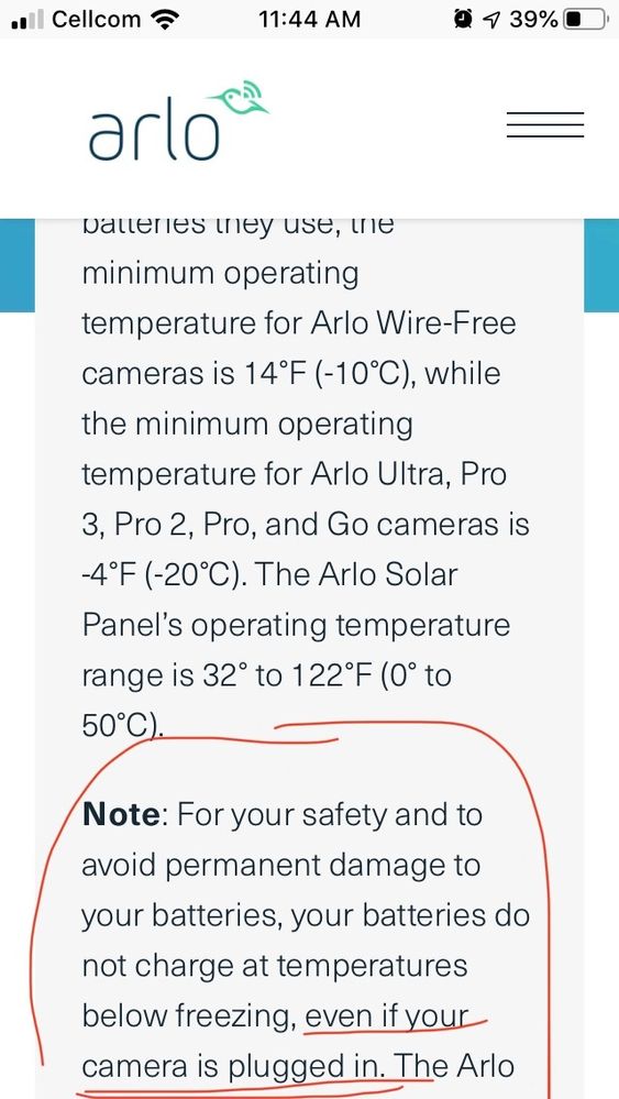

I currently have the Arlo Pro 2 camera system and all exterior cameras are plugged in, with no battery, because they do not work in the winter with batteries— the temperature frequently dips below the operating temperature of the batteries.
As per the specifications for Pro 2 batteries, they will not charge if I leave them in the camera and plugged in while the temperature is below operating temps. This is why I take the battery out and power it with the power cord only.
Since the new Arlo Pro 3 Cameras have magnetic chargers, does that mean I cannot use them in the same manner as my Pro 2 cameras (plugged in with no battery)?

Ok, but when I leave the batteries in my Pro 2 cameras, while it is too cold for operation , and plug them in, they do not work. I have to take the batteries out and then the cameras work. This is the case only when weather is below normal operating temps.

They work with batteries, just not at low temperatures, even when plugged in. See pic below. I found this on Arlo's website when my cameras wouldn't work in the dead of winter.

As I stated above, they did not work when I had the batteries installed and power cord plugged in. The Arlo comment was found after I discovered they didn’t work. I did not fear anything would happen; I took them out because they just didn’t work in the cold.
