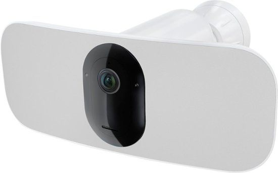

Not a floodlight, but a camera with a spotlight.  Various Arlo cameras charge differently, so knowing the model is important.
The only Arlo floodlight camera looks like this:
If you've already tried multiple chargers and cables, then it's likely that the camera has failed.  There's not much you can do with the Essential, because the battery is fully sealed, and not removable.
