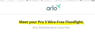

I changed my broadband provider to Sky FttP and my Floodlight (the only Arlo product I have btw) is no longer connecting via the app. With my previous Broadband supplier it connected without a problem
I confirmed my phone is connected to 2.4ghz band by shuting down the 5ghz band in the Max Hub app and confirmed in the router.io (See screenshot). Also changed the security to WPA2 as the router is wifi6.
When attempting to pair the device, the floodlight blinks blue and chimes with the QR code but fails to connect. Pressing the 'sync' button has the same result. I've tried this in the same room as the router and elsewhere in the house.
I've tried this with my laptop as well as my phone.
I've reset the router, forgotten the connection, setup the wifi on my phone again, disabled the 5ghz band, ensured there was only my phone as the connected device, set the security to WPA2 - still no luck.
Wierdly the motion sensor is working as the floodlight illuminates when movement is detected
Any help gratefully received

  • you have the floodlight, and not the ordinary pro 3?
  • and you are selecting the Wire-Free Floodlight?  You definitely don't want the wired floodlight (which for some reason is under "lights" and not listed under cameras).

Yes this is the Pro 3 Floodlight non wired version. I have been navigating to 'Light' and not 'cameras'
Interestingly though, if I navigate to 'cameras' and select the 'pro series' it directs me to the same place
