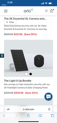

- I am purchasing two bundles.
I know with my old arlo system I had to have a hub. Sadly, I can’t get most of my cameras to charge anymore- all the batteries charge and will all work in my one working camera, but the other cameras won’t turn on 🤷♀️
So I picked out two bundles, neither of these bundles specify a hub- so do I have to buy a separate one?
or am I going to end up with two hubs buying these bundles?
I am trying to spend less money- but get what I want.
my goal-
floodlight with solar
doorbell (solar if possible)
at least 2 cameras- one will be outside, one inside-
I picked one bundle with a door bell, 2 cameras and 2 solar panels
one bundle is the floodlight and one solar panel.
I chose to get the floodlight bundle because it didn’t look like the solar panels in the camera bundle were compatible with the floodlight.
am I on the right track or do I need to scrap this whole cart? Add something else?
thanks!
