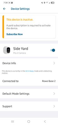

One of the Arlo Pro 2 cameras in my account went offline randomly as it does every couple of months. After going through the normal process of deleting it and readding it, I was suddenly greeted with a ( ! ) icon and a message telling me I now needed to buy a subscription. That's not the case for the Pro 2 and has not been this whole time. All other cameras are online and recording for 7 days without a subscription.
I have tried deleting and readding and ensuring all rules are also deleted. Nothing has worked. From what I understand, Arlo may need to resync manually on their side.
To make matters worse, I can't even speak to live chat without a subscription any longer, so if this can't be resolved through this thread, I'm SOL. Please update the EOL policy for the Pro 2 cams if something has changed.

It's not. I have deleted and readded this Pro 2 camera at least 8 times at this point. Each time, when it pairs to the base station, I am presented with only 2 options - select a subscription or "maybe later". Regardless of which I select, there is no option for a free trial nor is there an option for the legacy 7-day Pro 2 subscription.
Up until this camera experienced a technical issue where it lost its connectivity to the base station, it was working fine in this account. On it, there are two base stations - the first one has 3 Pro 2 cameras and the second base station had (prior to this camera experiencing the technical issue) 4 Pro 2 cameras. If someone is going to chime in here and say that that's too many cameras for the legacy Pro 2 subscription, then please advise why this setup was working just fine up until this camera experienced a technical issue. Otherwise, please advise on what exact steps need to be taken in the app to get this camera back online.

Neither - it returns to devices where it shows a red (!) icon over a greyed out BG for the camera. From there, my only option is to subscribe to a paid plan.
Can you please send me screenshots of what you are seeing?
I have been trying to delete and reconnect this Arlo Pro 2 camera using different orders of operation and I always get this result no matter what. There is never an option for a free trial. The app is treating this camera like any other newer model camera. Device has now been unusable without a paid subscription for close to 2 months.
