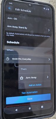

I'm helping a friend who is on the new app interface (I, thankfully have not been forced yet)
I cannot get the schedule to change at the specified times. I have deleted the automation schedule several times and started over. Updated the app, Uninstalled the app and reinstalled. Restarted android phone.
I have compared to other user's screenshots and this is set up the same.
I have tried test schedules and they will not change either.
I want to arm away at 10pm and standby 6am.
(I have a more complicated schedule set up for another user that is working perfectly)
Images Attached of modes and schedules.
Can anyone tell me what I'm missing?

These automations are set up to run only when the system is in Arm Away or Standby mode. They will not run when the system is in Arm Home.
Is that what you intend? If so, did you put the system into either Arm Away or Standby when you created this schedule?
I removed all the rules for arm home and will not use the arm home mode.
I've put the system in both arm away and stand by manually from the dashboard, trying to get it to initiate with no luck
